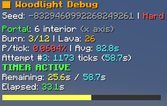

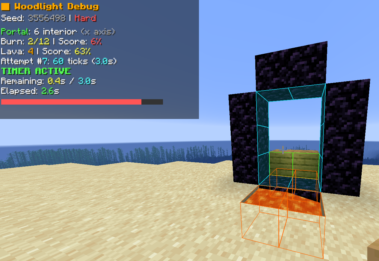

DEBUG MODE
If you run the debug jar file, you will have a keybind [J] which opens a GUI and also highlights the nearest detected portal. Used for debugging and testing.

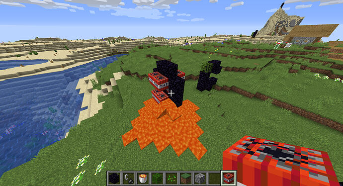

  • with the current implementation of your mod, a setup like this is now one of the optimal wood light setups among with the infinitely many others. implementing such changes drastically discourages strat development.
