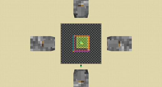

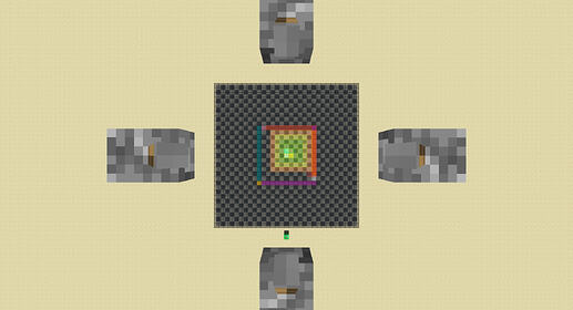

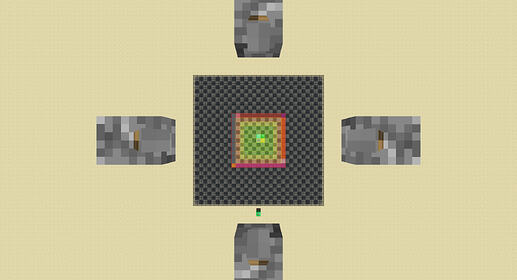

Hyper Enhanced Negative Pie-Ray (shown under map v2.0.1)

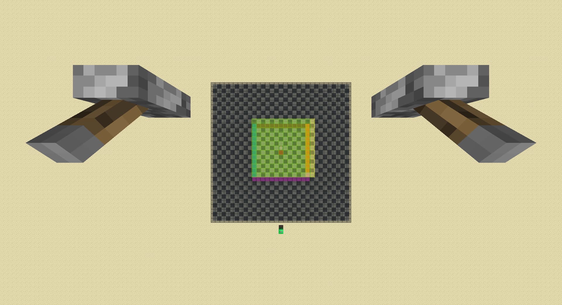

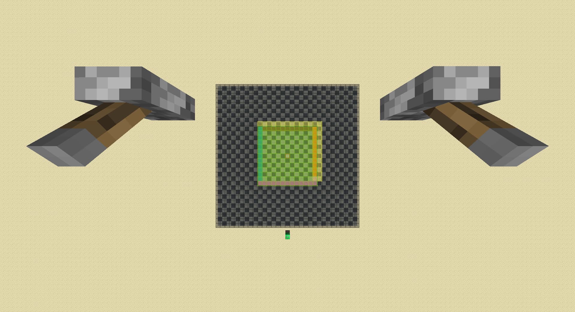

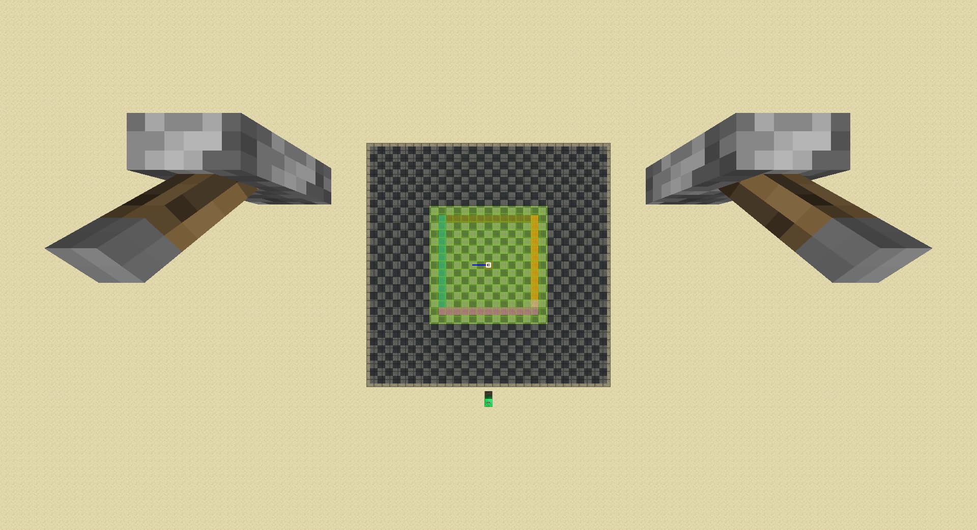

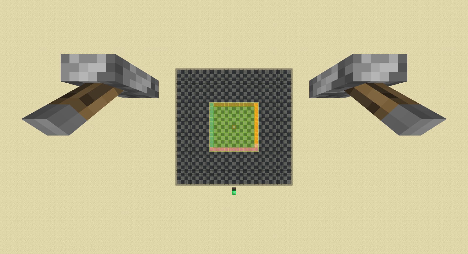

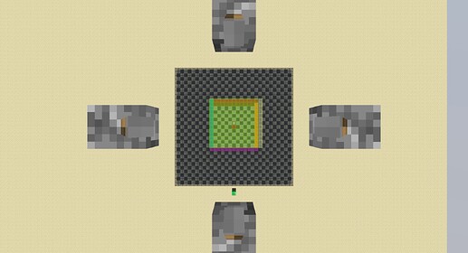

  1. lower rd to 3(2 works too):
  2. raise rd till spawner loads(do not overshoot):
  3. lower rd by 1:
  4. move forward by 1 chunk, detects spawner in magenta if spawner unloads:
  5. move right by 1 chunk, detects spawner in cyan if spawner unloads:
  6. lower rd by 1:
  7. move left by 1 chunk, detects spawner in orange if spawner unloads:
  8. move back by 1 chunk, detects spawner in red if spawner unloads,
    otherwise detects diagonal spawner in pink:

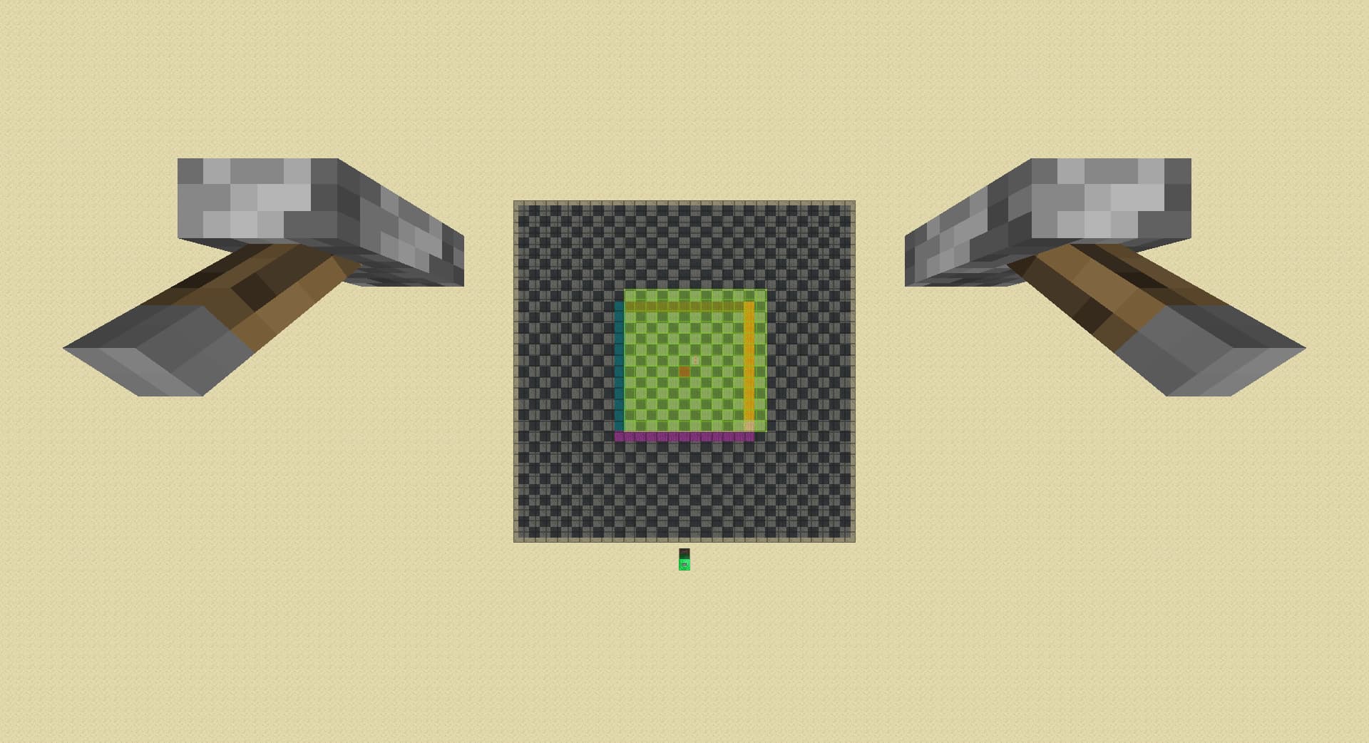

alternatively, after step 5:
  1. instead of lowering rd by 1, move left by 1 chunk:
  2. lower rd by 3, detect spawner in orange if spawner unloads, otherwise detect spawner in brown:

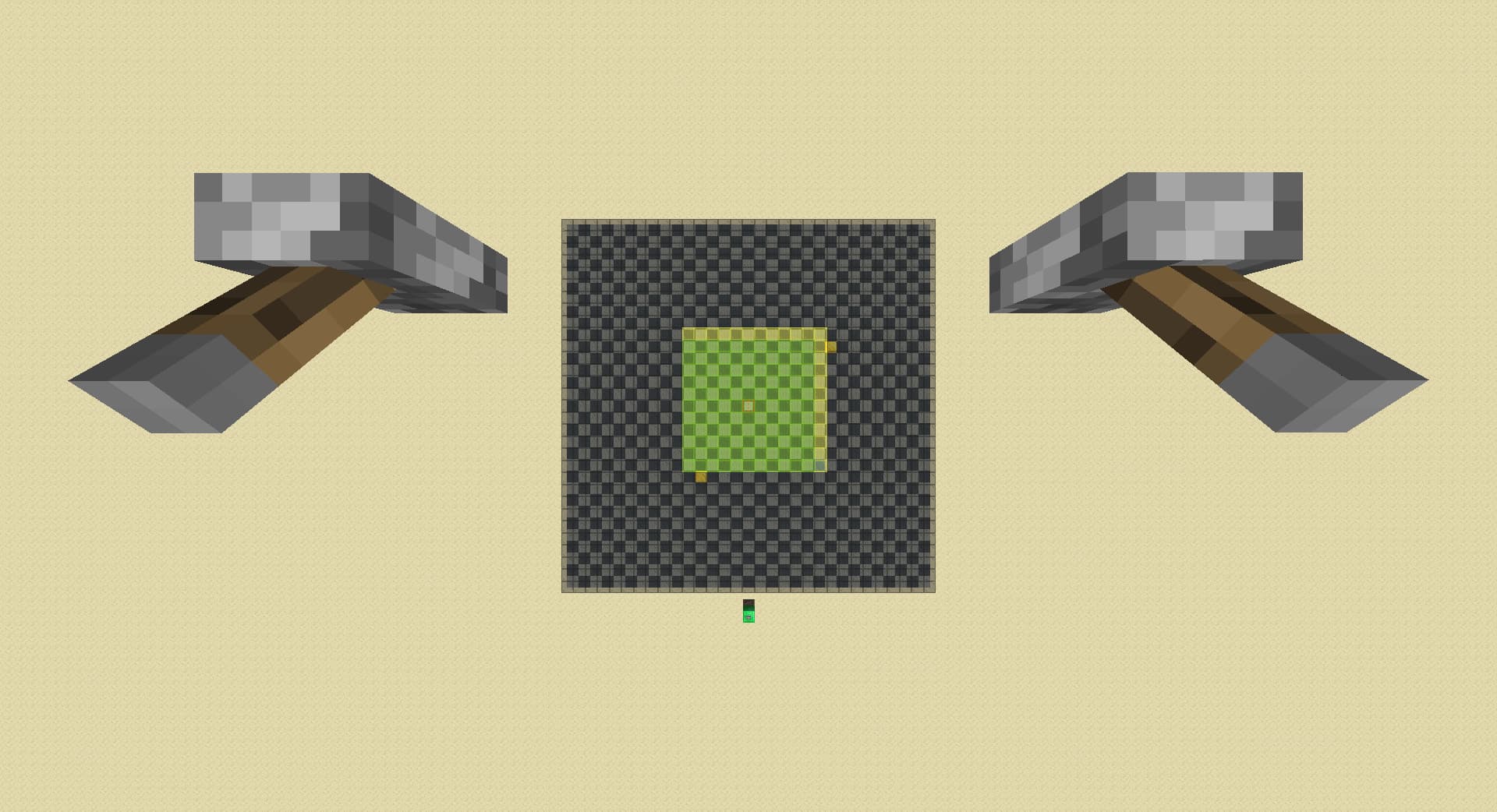

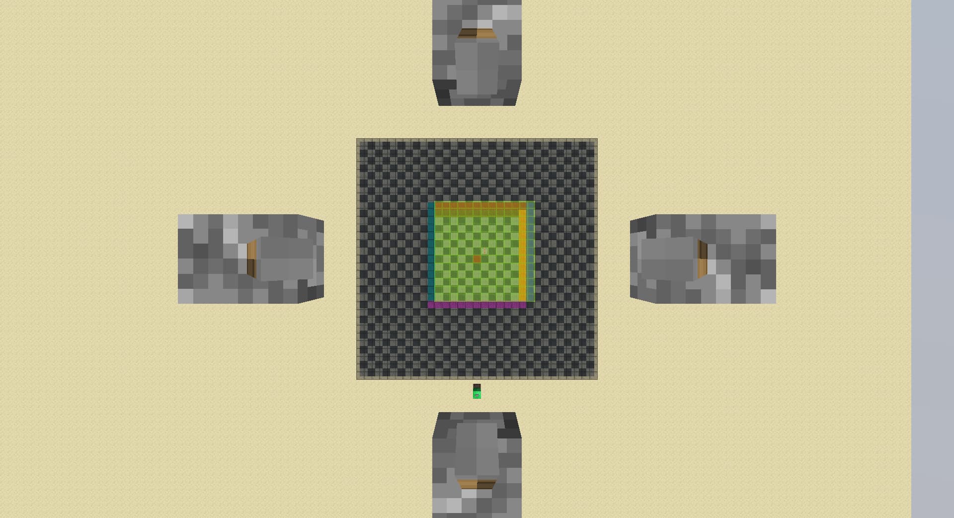

Pie Ray Simulator Map
map v2.1.1
Fixed the issue mentioned by @ymiTAS.
map v2.1
Added a simple practice feature for practicing any pie ray method, every time the lever is flicked 2 spawners spawn in the pie-ray-able region within 16 chunks.
map v2.0.1

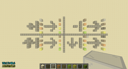

There are coloured wool placed around the map at corresponding chunks of the example shown below for verifying cases. To verify a case, place a spawner on top of a wool block and break all other spawners, do the same actions both with the levers and yourself, and see if a spawner is on pie when the map shows a chunk have (red,orange,yellow and lime) stained glass above.
map v1.1
Capable of explaining basic pie-ray we know and loved, not capable of explaining the ‘Hyper Enhanced Negative Pie Ray’ shown below.
Note that in all pie ray case examples shown, you have to stand in the chunk with the levers, face towards the render distance levers, walk explicitly front then right, then left then back, doing anything wrong will result in inconsistency with the example.
(you can do other direction sequences, its just the directionality of cases will change)
The hyper enhanced negative pie-ray compared to the basic negative pie-ray, removes confusing and time consuming far spawner situations, takes (arguably)less time to setup, is easy to switch to(you can tell comparing both showcase in the map that the colors to show which chunk belongs to which case didn’t change).
According to my test, the basic pie ray is actually ~0.2s faster on average in the case of a 13 chunk(roughly cuts all spawners in half) diagonal spawner. I came up with a couple micro improvements over the new pie ray which the basic one couldn’t benefit from, which likely makes it faster, but haven’t tested:
  • Instead of going all the way down to 2 rd without checking, go down to ~9 rd and check if spawner is unloaded.
  • After the spawner is unloaded, the first 3 rd raised cannot load in spawner so can be spammed.
  • Faster key repeat can speed up the process of dropping rd.
If you have a micro improvement that you are not sure if it works, try it with the map and see if the behavior are the same(no extra chunks loaded, no extra chunks cached, etc.)
Information below have less time put into tidying up, I mostly just re-ordered them:

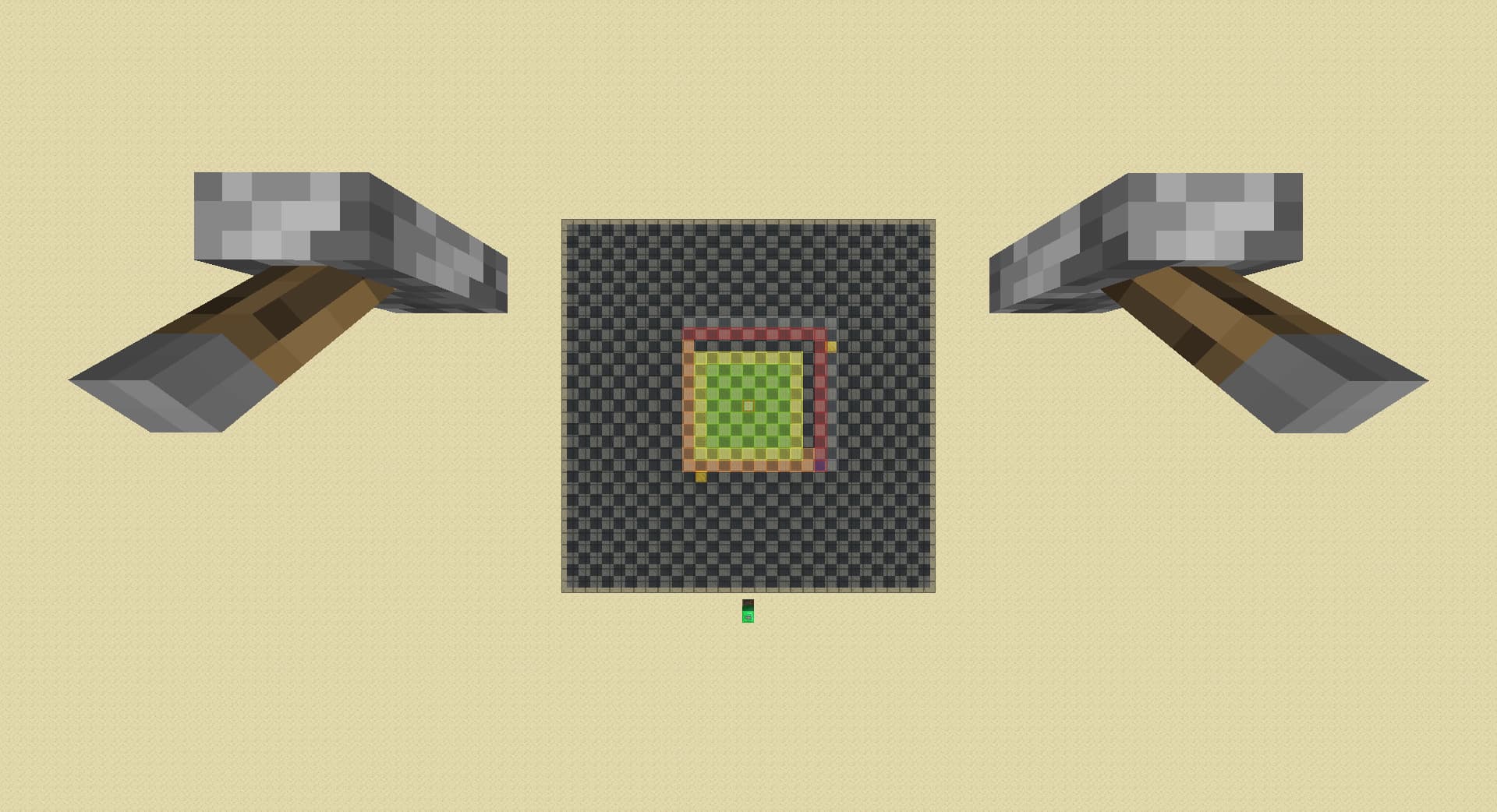

  1. lower rd to 2:
  2. raise rd till spawner loads:
  3. lower rd by 3:
  6. lower rd by 1, detects spawner in pink if spawner unloads:

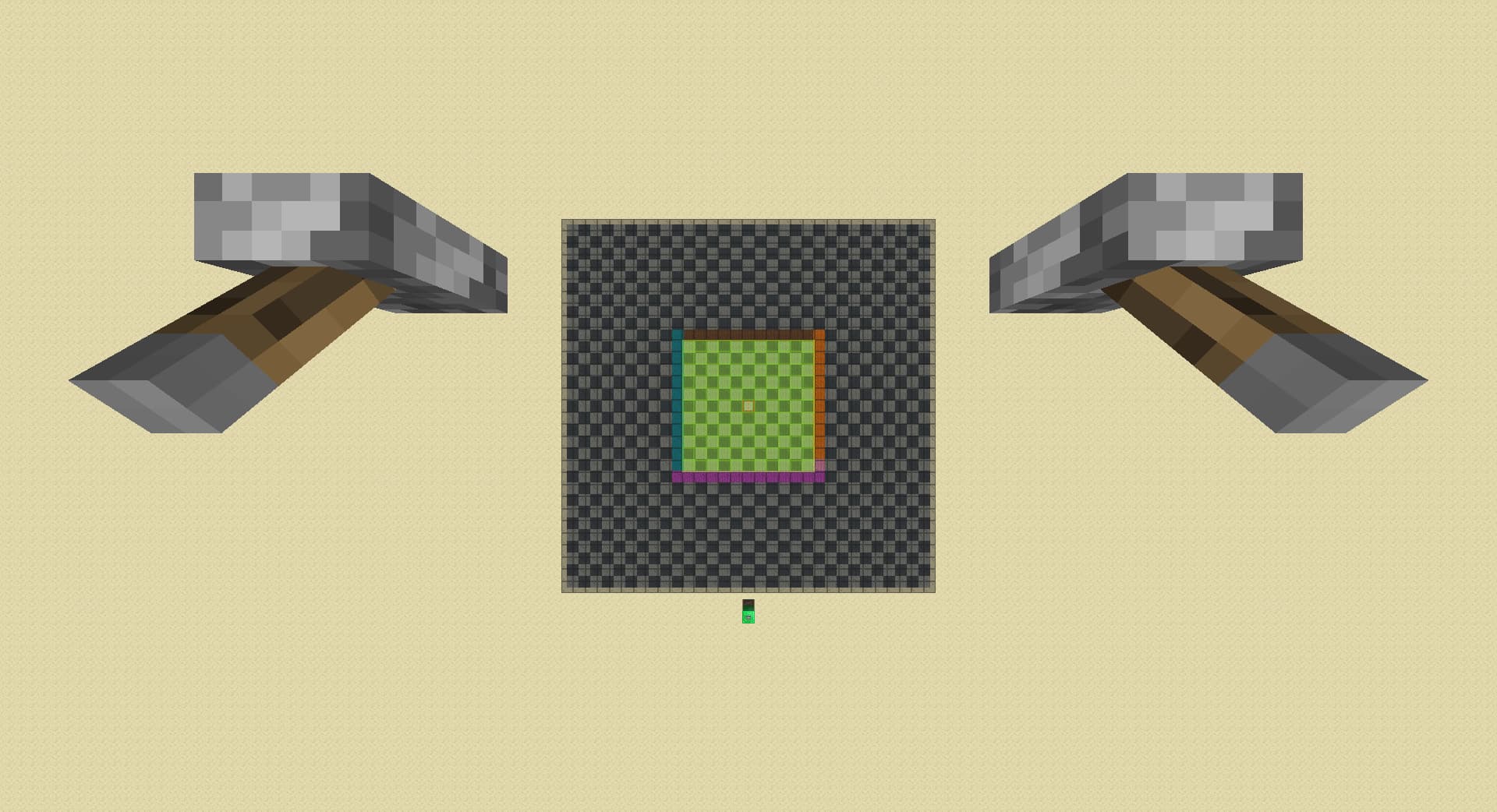

How Minecraft Block Entities Renders On Pie
tl;dr: (replaced brown with red)
down till 8 rd from 32:

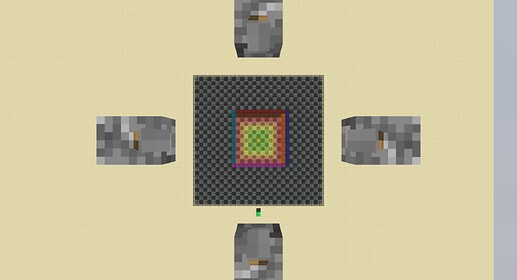

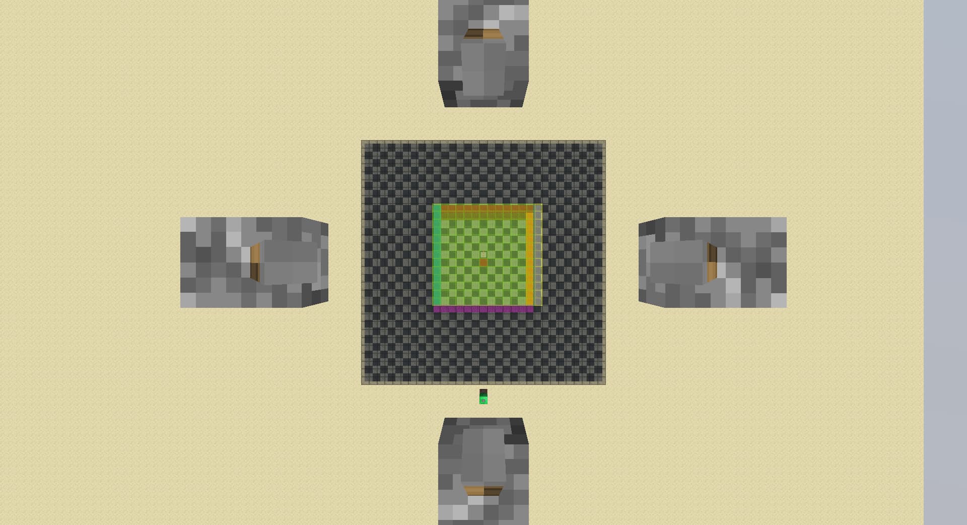

Let’s name the border of green entity ticking chunks r0(lime), the chunk ring outside of r0 r1(possibly yellow), the chunk ring outside of r1 r2(possibly orange), the chunk ring outside of r2 r3(possibly red), and so on(possibly black). Just to clarify, ‘lazy’ chunks or ‘TICKING’ chunks are only the r1 chunks. Outside of the colors listed above, there are gray chunks which I will explain later.
Spawners within chunks in r0 or below(lime) are always loaded on pie. Spawners within chunks in r1,r2 and r3 may or may not be loaded on pie, and is loaded if colored yellow, orange or red with respect to the ring it is in in the map. If it is not loaded on pie, then it is colored black. Spawners in r4+ are never loaded on pie.
When the player moves and a chunk moves away from them(r0 -> r1, r1 -> r2, ...), the color of the chunks downgrades accordingly(lime->yellow, orange->brown), with two exceptions: when previously r1 chunks move to r2, its color changes to black(fully unloaded); when previously red r3 chunks move to r4, its color changes to gray(unloaded from pie, but cached).
When the player moves and a chunk moves towards them(r1->r0, r2->r1, ...), the color of the chunks upgrades accordingly(yellow -> lime, orange -> yellow, brown -> orange), with two exceptions: when previously r4 cached chunks(gray) moves to r3, its color changes to brown. When previously r4 unloaded chunks(black) moves to r3, it remains unloaded(black).
When the player lowers render distance, the color of the chunks downgrades accordingly(r0 lime -> r1 yellow, r1 yellow -> r2 orange, r2 orange -> r3 brown, r3 brown -> r4 black) with no exceptions. Cached(gray) chunks anywhere(even millions of blocks away) in r4+ also gets uncached and downgrades to unloaded(black).
Finally, when the player raises render distance, the color of the chunks upgrades accordingly, and the rules of upgrade follows the same rules when you move towards them.
I realised that in the case of player moving away from the spawner, when previously r1 chunks move to r2, its color changes to black(fully unloaded) means that we can just drop rd by 1 instead of 3 in a diagonal spike case:

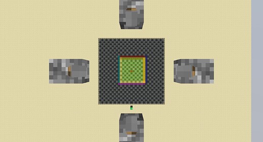

drop by 1, move left then back 1 chunk each:
drop by 3, move left then back 1 chunk each:

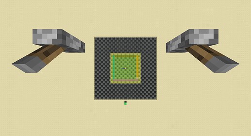

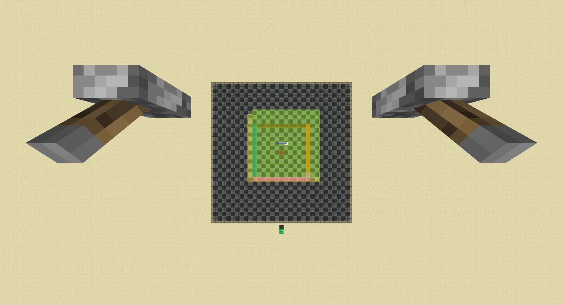

My guess on why mojang make block entities in chunks to load and unload like this, I think it might be helpful to understand it:
When the player plays normally, they don’t change their render distances.
a player joins world on 8 rd:
move forward 1 chunk:
move right 1 chunk:
move forward 1 chunk again:
There are only 1 ring of yellow lazy chunk, in case the player walk back to the exact chunk border they just crossed immediately.
raise rd by 1:
When the player raises render distance, only the chunks that will be immediately used loads in.
lower rd by 1 from 8:
lower rd by 1 again:
My best guess is that when the player is moving, they are very likely to keep moving in the same direction, so it is ok to just unload chunks 2 away from green; but when the player lowers render distance, the game have no idea where the player wants to go and therefore unload chunks when they are much further at 4 away from green because loading in chunks costs a lot.
move forward 1 chunk after lowering rd by 3 on 8:
I can only assume that the game did not properly handle situations when the player move after lowering rd, it only handled the unload of the second ring(yellow -> orange), but not the rings outside. These rings’ load level then are misinterpreted by something else in the code, which I suspect is world generation thinking the player walked away in the middle of generation of something, so the game doesn’t discard it after the player leave the range, but instead puts it in cache. This cache will get reloaded immediately when the player walks back in range, and nothing including autosave clears it in the memory.
lower rd by 1:
Only when the player lowers rd, the game thinks the player might be experiencing lag and clears it out from cache.

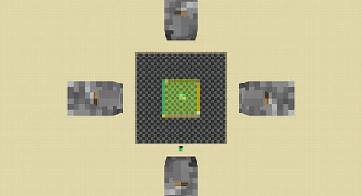

  3. lower rd by 1:
  4. move diagonaly front-right 1 chunk(order doesn’t matter),
    go to case A if spawner unloads, go to case B otherwise:

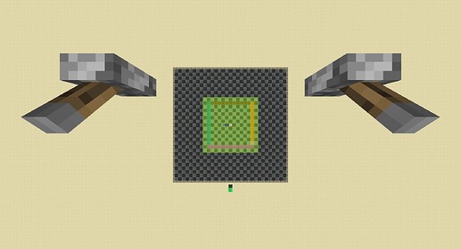

map v2.1
Also added an icon:
elite introduced the idea of increasing the amount of diagonal cases to have more chance to be able to pin point the exact spawner location. I’m quite confident that this is the best possible solution to increase diagonal spawner cases to 4, in expense of 1 extra move half the time:

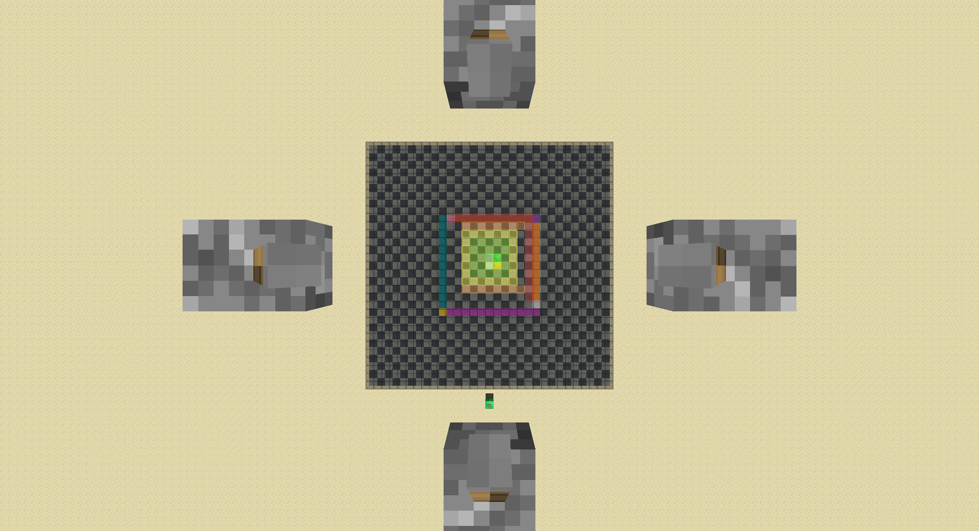

Enhanced Negative Pie-Ray (Gamble variation)

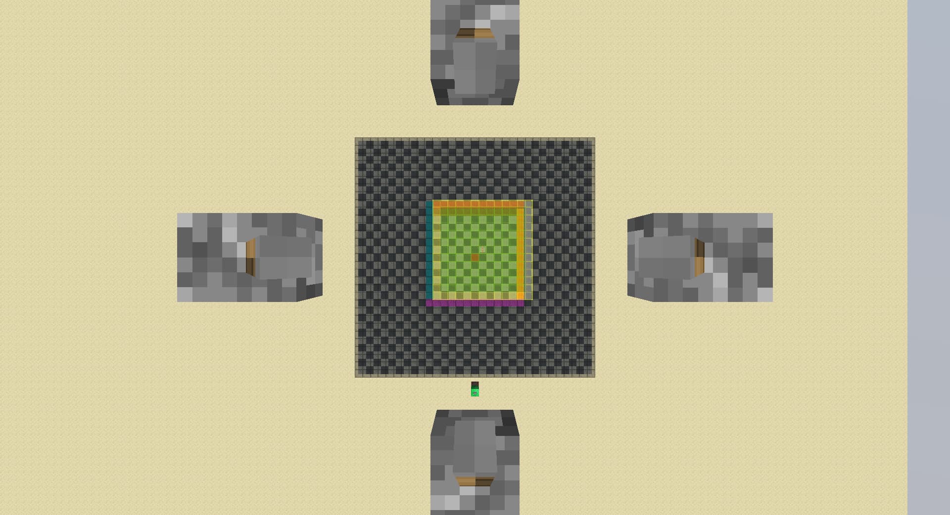

  2. raise rd till spawner loads(you can overshoot with this one, just lower it back down):
  3. lower rd by 3:
  4. move forward by 1 chunk, detects spawner in magenta or yellow if spawner unloads:
  • 4.1 in case spawner unloads after step 4, move diagonaly back-right 1 (ideally right then back, doing the other way around will require refreshing pie), detects spawner in magenta if spawner loads, otherwise detects spawner in yellow:
  1. move right by 1 chunk, detects spawner in cyan if spawner unloads:
  2. lower rd by 1, detects spawner in pink or white if spawner unloads:
  1. move left by 1 chunk, detects spwaner in orange or purple if spawner unloads, otherwise detects spawner in red:
  • 7.1 in case spawner unloads after step 7, move diagonaly back-right 1 (ideally back then right, doing the other way around will require refreshing pie), detects spawner in orange if spawner loads, otherwise detects spawner in purple:
I think this might be useful when the pie ray is overlapped like in bridge, and the 1/n (n being the distance of the spawner) chance you get the exact chunk coords of the spawner can very well just win you the game.

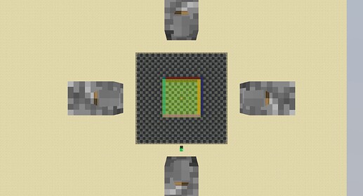

You have a bug. U should just tp render armor stand back at rd2 without activating rd3. Because it remove all grey chunks and its not true. It only happened when u actually lower(rd was > 3)
How to recreate bug:(↓ to RD3 -z ↓1 +z and it doesnt load back grey chunks cause it delete it
good catch, i thought i fixed that bug in one of the updates, but i probably just fixed it in an old version of the map instead.
as for the second part, i’m assuming you are testing around overworld spawn chunks given that you are saying the spawner is in (0,5) , if that’s the case it is known to be causing strange behavior that i have not tested yet.
