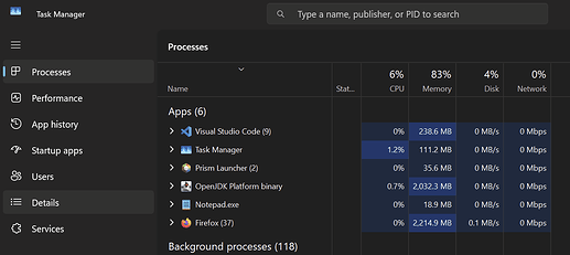

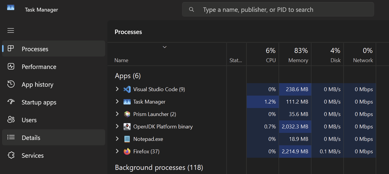

etc, then you have access to jstack. yippee! next we need the id of the minecraft process. to get this we’re going to look in task manager, which you can open with the shortcut ctrl + shift + esc. we need to go to the details tab, which is the tab that’s second to the bottom and has the icon of 3 lines.
click on that, and then we need to find javaw.exe. there’s also a rare chance you’re using java.exe. if the details tab is not sorted by name then clicking on the title of the name column will make it so. if you have multiple javaw.exes, make sure you don’t have multiple instances open, or other java programs (close ninjabrain bot). also, if it’s some random java program like modcheck you can usually tell by cpu usage (focus the game and spin around, cpu usage will spike a bit for one entry).
once you find the right entry, take note of the number to the left of the name, in the PID column. it will be some 4-5 digit digit number. go back to the window we ran that command in before. we’re going to now run the command jstack -l -e PID > out.txt (that’s a lowercase L), where PID is replaced with the number you wrote down (e.x. jstack -l -e 31148 > out.txt, but the number will be different for you).
